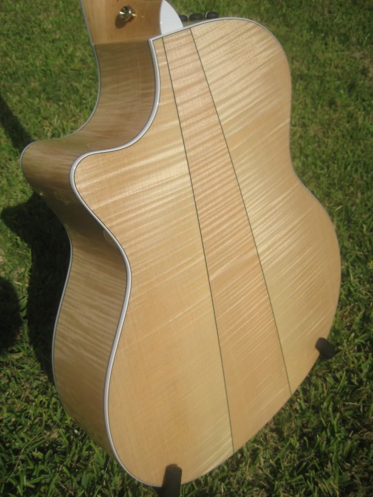

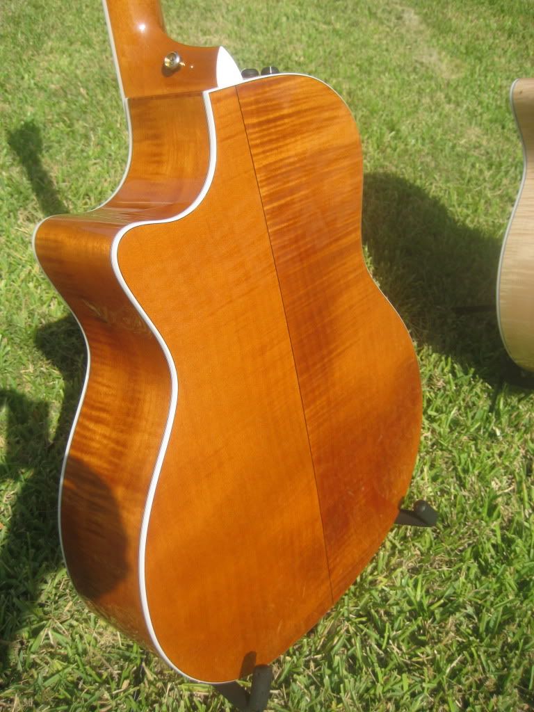

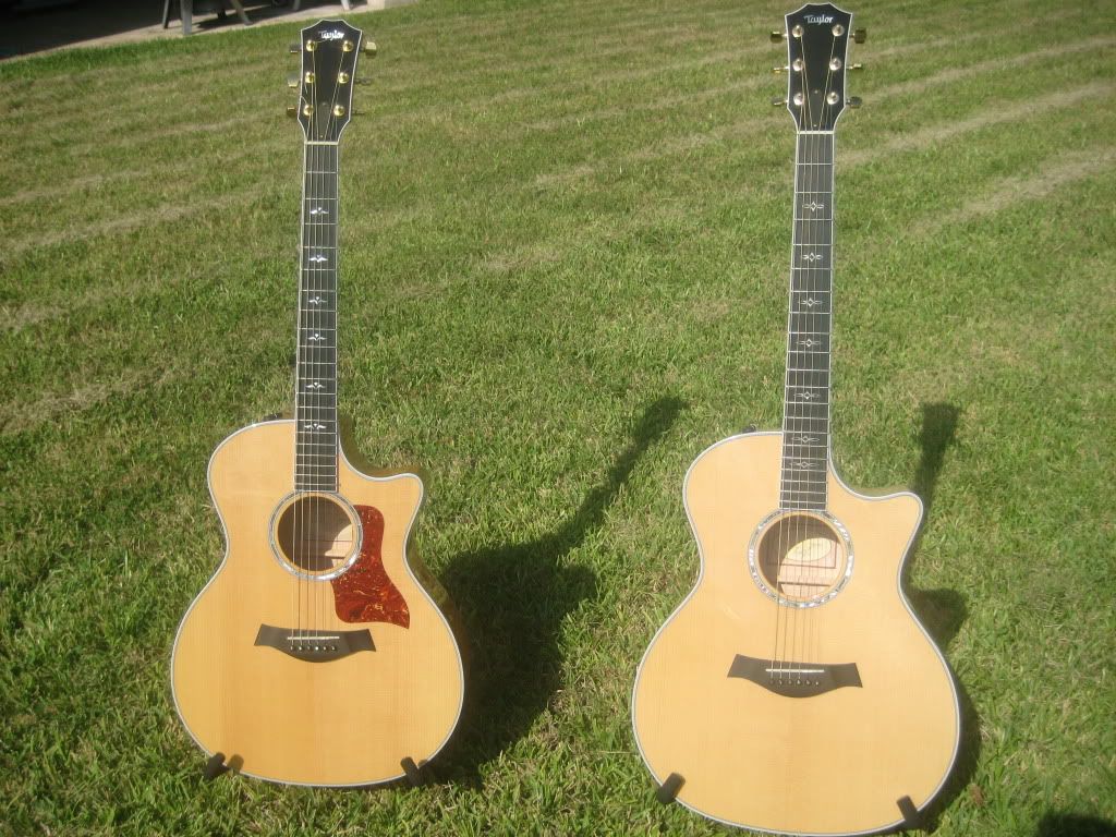

614ce, 2008 (left), 2012 (right):

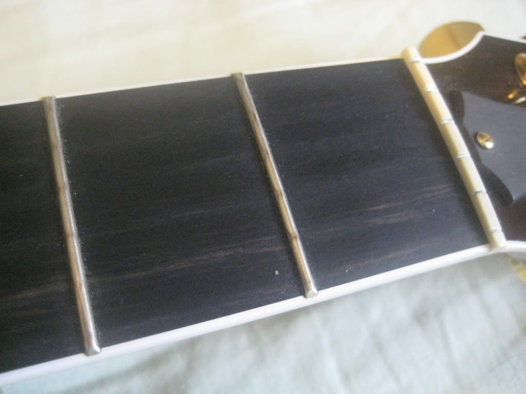

2008 614ce Fretboard at Nut:
2008:
2012:

The action at the nut has more to do with making your fingers hurt than any other factor in my opinion.  That is excluding ridiculously high action at the saddle or a bowed neck.   You can check it by pressing the string down to the fretboard between the second and third fret and holding it, then push the string down on the first fret and see if there is a difference.  You should only have about the thickness of a sheet of paper between the first fret and the string when it is fretted at the third fret.  The only right way to check it is with a good gauge, but you can eyeball it and tell if there is a marked difference.

@tamiller,
Thanks I will do this check on both 614s!

... You can check it by pressing the string down to the fretboard between the second and third fret and holding it, then push the string down on the first fret and see if there is a difference.  You should only have about the thickness of a sheet of paper between the first fret and the string when it is fretted at the third fret.  ...
I checked this on both the 2012 and 2008 614ce guitars.  The 2012 is as you describe (paper thickness).  The 2008 has a noticeable gap between the string and the first fret.  This is using the big E string fretted between the 2nd and 3rd fret, and testing clearance at the first fret.  Both guitars check "ok" with the small E doing the same test.
So now what, does this mean if I want to keep the used guitar and have it play easy, take it to a tech for a setup?
Thanks!

Yes, unless you have a set of files and can do it yourself.  I've got a nice set of files and do a setup on all my guitars, but it's cheaper if you're only working on one to take it to a tech.  There are lots of resources to show you how to do a good job of it if you choose to do it yourself.

the 08 model has the second body sensor, 'op-amps' preamp & the humbucking
dummy coil was still located underneath the fretboard extension (i believe) -
also it has a 2 piece back with amber stain back, sides & neck
the 12 model has the single body sensor, discrete amp, the 'dummy coil'
is installed on the soundboard, a 3 piece back (extra backstrip) & natural finish (no stain)
i believe there would be very little change in weight, based on these differences & that the
08 MOP 'leaf' inlays would weigh much more than the 12 engraved pearloid 'twisted ovals'
even if the 08 model was severely overhumidified, save for standing water,
the difference in weight shouldn't be substantial ... at least on paper anyways
on-the-other-hand, if a different wood thicknessing spec was phased in after the 08 model was made
then there might  be a perceptible difference (with all the other variables taken into account)
congrats on the 08 :D
i hope that with a little work on the nut slots, it will play as easy as your 12 :)
« Last Edit: July 25, 2012, 10:13:14 PM by michaelw »

I agree with the nut issue above.  It does not take much difference in nut slot heights to make a guitar an effort to play versus a joy to play.  I've lowered the nut slots on all of my Taylors.  The factory setups are not always optimum, especially if they just pop in the standard prefab Tusq nut.
If you have the proper size files, its fairly easy to do using the feeler gage method with the feeler gage being the stop for the bottom of the nut slot.
Another neat trick is to use feeler gages as the slot cutters.  Pick the six feeler gages you want for the widths of the nut slots.  Then gang the six feeler gages together and use a triangular jeweler's file to file teeth in one edge of the gages, across the gage thickness.  Keep the file at an angle so that the cutting edge of each tooth is perpendicular to the edge of the gage.   File the teeth about 1/16 inch or less from each other.  When complete, you just draw these cutters through the nut slots to deepen them, using other feeler gages under the strings to stop the cutting when you reach the right depth.   If you're just doing a few guitars, this is a great inexpensive method.  Just costs you two sets of feeler gages (pretty cheap at Walmart, and a triangular jeweler's file.
