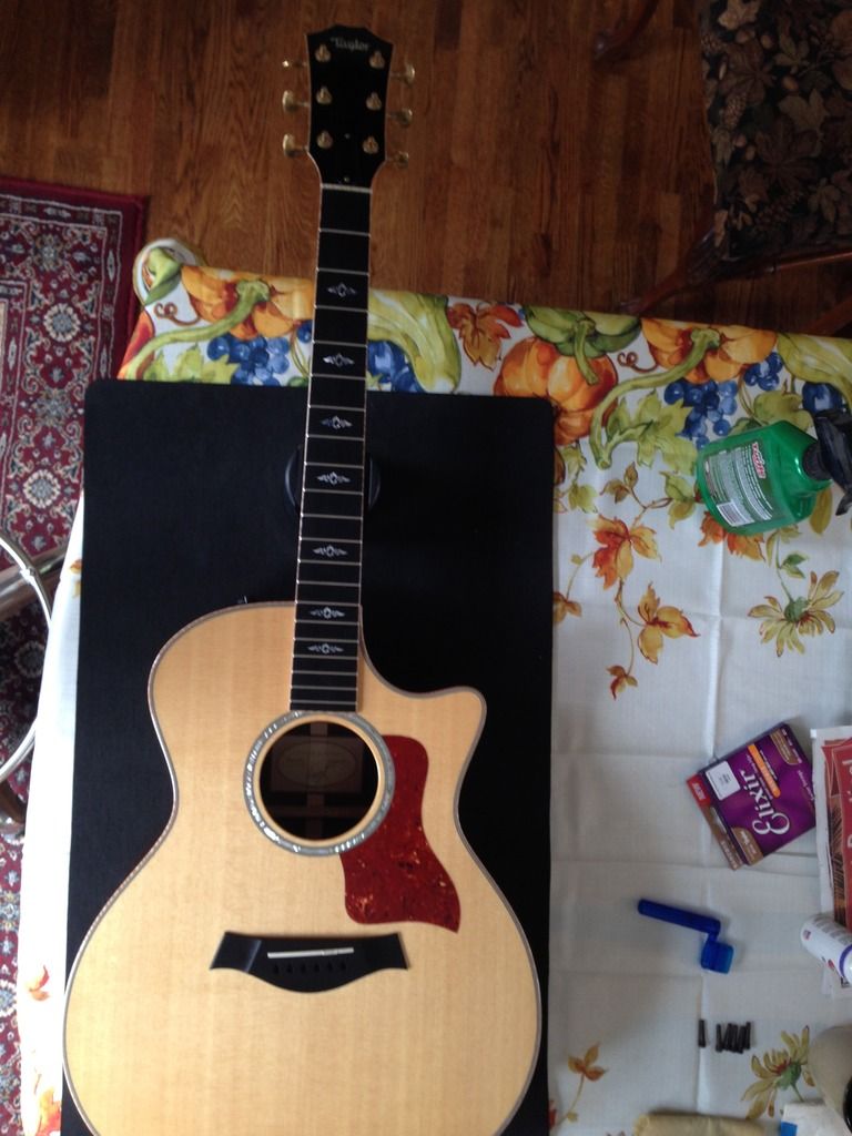

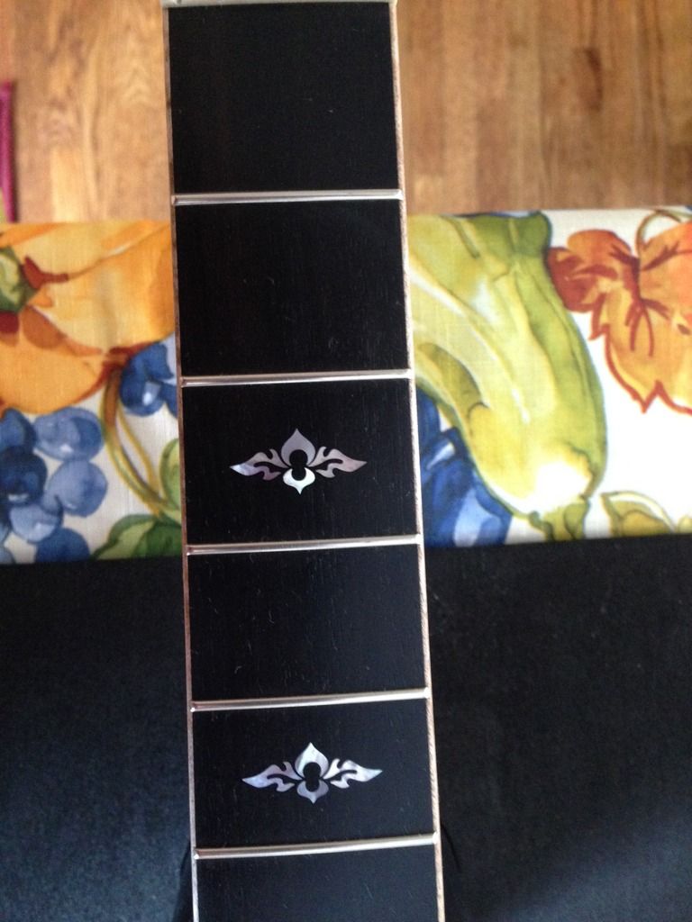

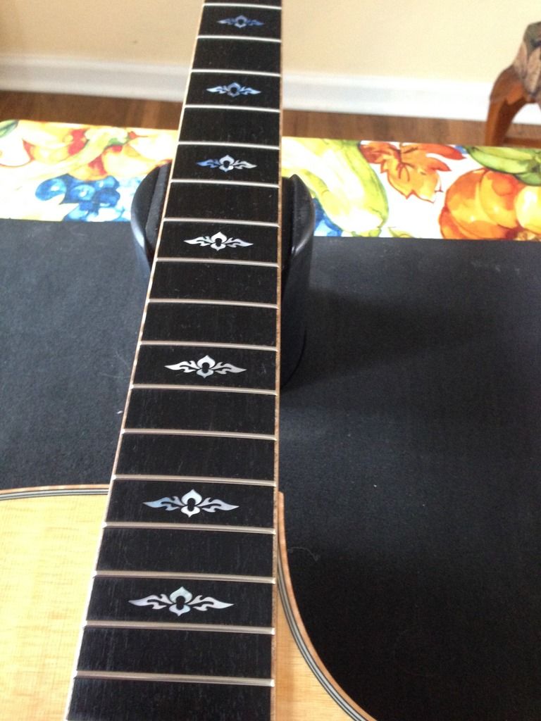

I got up fairly early today and decided to give a String change to my 814e LTD.  Tuned it up and WOW did that make a difference.  Went with the Elixir Nanoweb HD Light strings.  They are .013 to .053 It is true the do give a bolder high end, and a fuller low end.  I am loving it.
While I was changing strings I decided to clean it up a bit.  Thinking back I believe I have not done this for a couple of years.  It was pretty grimy.  After using steel wool on the frets I put Kyser's Dr. Stringfellow Lem-oil on the ebony fingerboard and bridge, they are looking very nice.  Then I cleaned the body with Lizard spit of coarse and polished it up with Turtle wax Express shine.  This has to be one of the most extensive cleaning jobs I have done on this guitar in a very long time.
Wanted to show you the fretboard with the strings off.

The first thing I do is to place a paper towel over the sound hole then tape it down with blue painters tape.  I then use oooo steel wool to brighten up the fret wire and clean out the grime next to the frets.  After that I'll use the lemon oil liberally, then a good wipe down to get all the excess oil off.  The pictures are after the oiling.  After that I go for the body work.

What are you using for the neck support?
The StewMac work bench comes with a plastic tube, foam mat, and neck support that acts as one end to the tube.

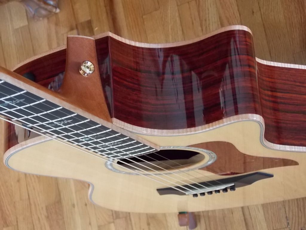

Can we see the back?  :o

Not that great of a picture But....here you go.

Thanks, that is beautiful! It seems like every cocobolo back is very unique.
