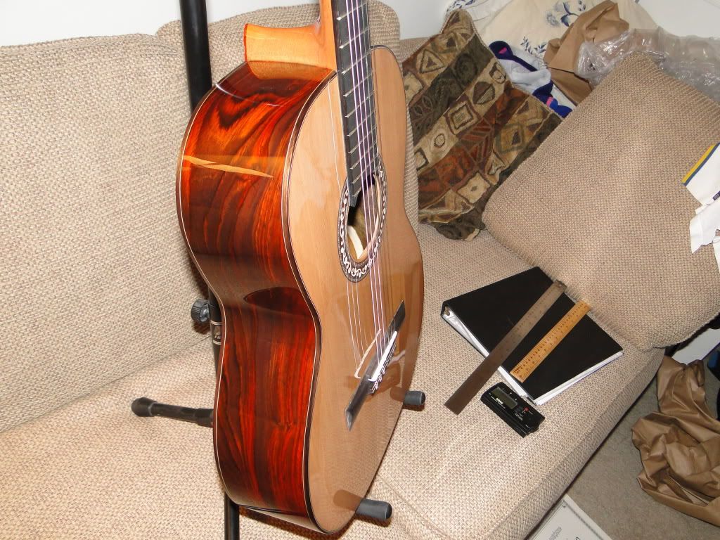

Simple question, really. Judging by its price, I'd always assumed this wood was difficult to obtain or scarce, like koa, but I read recently on one site words to the effect that it was plentiful in Mexico. I recently bought a Kremona Solea classical in cedar and cocobolo that was very reasonably priced, but Taylor acoustics with this wood are among some of their most expensive, if I'm not mistaken. So, is it marketing or scarcity, do you think?
P.S. I don't know how far the cocobolo has affected the sound on my new classical, but it is gorgeous. The guitar was bought online and had a sizeable discount, and I decided to take a risk just to see what the cocobolo would be like.

« Reply #12 on: July 09, 2012, 01:01:40 PM »
Well, this Kremona Solea certainly has both the looks and the sound.
Re: Why is a guitar made with cocobolo so expensive?
« Reply #13 on: July 09, 2012, 02:58:52 PM »
That's a-nice!!!!  Beautiful instrument, sir!
